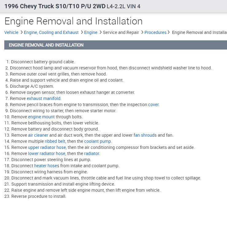

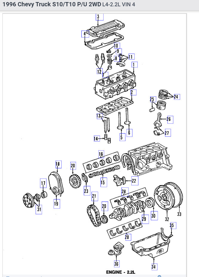

Will a 2.2 liter engine out of a 98 S-10 work in a 96 S-10 that has a 2.2 liter?
OLERICK
MEMBER
1996 CHEVROLET S-10
Will a 2.2 liter engine out of a 98 s-10 work in a 96 s-10 that has a 2.2 liter
Thursday, June 17th, 2010 AT 8:26 AM
SQM
MECHANIC
6,383 POSTS
Yes, that engine will work.
Here is a helpful engine replacement video:
https://youtu.be/zy1CozLgWUQ
I have attached the engine replacement steps below.
