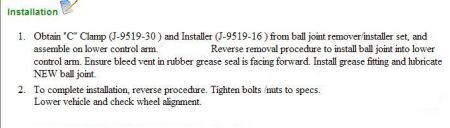

Right side lower lball joint replacement, Is it
press in from the top or bottom of the lower
control A arm?

Below are the proper replacement procedures..
