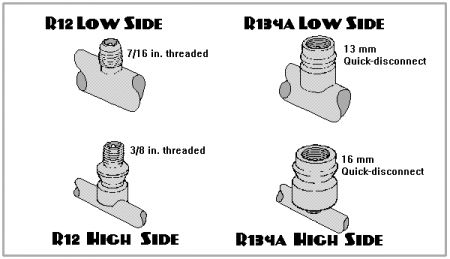

I trying to charge it and not sure which one is the inlet line?

Is the R-12 system converted over to R1341a system if so you must charge it thru the low side-suction line see below ports to identify the fittings
