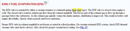

Tapping noise from engine when in gear or when engine is under load. Dont here noise when revving engine. Goes away when driving engine warm.
Sunday, February 10th, 2008 AT 9:04 AM
MERLIN2021
  • 17,250 POSTS
Check on the exhaust where the pipe meets the manifold for the EFE valve, could be the butterfly inside has finally come loose!
https://www.2carpros.com/forum/automotive_pictures/62217_86_EFE1_1.jpg
https://www.2carpros.com/forum/automotive_pictures/62217_86_EFE_1.jpg
