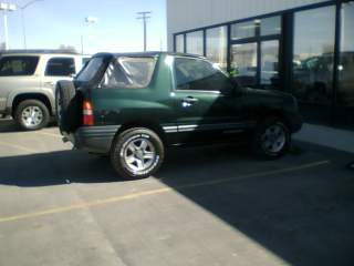

I have gone insane trying to find out why this is happening. When I take the remote locks modual out the light does not work at all but as soon as put in back in only while driving the light flashes.
I have replaced all the door switches and nothing changed. I even took the door panel off to see if there was a pinched wire (there wasent).
Pls Help
03 Chevy Tracker 2.0l I4 engine

I found out why and fixed it. Now no longer flashes. I found that the back tire bent the door and the trigger was not being pushed. So I took a piece a wood and bent it back.
Thanks for trying to help
