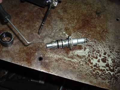

Is there a replacement fitting for the pressure hose fitting to the reservoir that the pressure cutout switch to the AC is available? Where could this be purchased?
I've been told that this fitting is worn and leaking and they are no longer made.

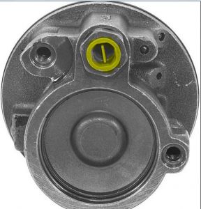

Can you elaborate as to what do you have for vehicle model year and engine size
most Chevy power steering high pressure hose connected to the rear of the P/S pump and to the gear box
if its the fitting at the pump side that need to be replace its a part of the pump

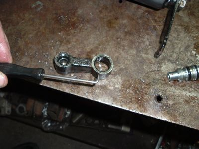

2000 Chevy K-2500 ,350 CID , 5 sp- transmission, VIN-1GCGK24R0YF483088
At the point of connection to the power steering pump is there a replacement fitting for the connection to the pump and is there a replacement part Available for this connection?
Photo's Attached
https://www.2carpros.com/forum/automotive_pictures/582375_2000_HD_Chevy_Winchester_KY_001_1.jpg
https://www.2carpros.com/forum/automotive_pictures/582375_2000_HD_Chevy_Winchester_KY_002_1.jpg

Its a part of the pump
for under $ 40 you can have the pump as a whole

Mo it's not part of the pump. It is a retrofit item that replaces the items shown in the photograph and is available from a Chevrolet certified parts supplier for about $77.00.
I found this information after I requested the information from you and the answer didn, t fit the problem. The fitting I was inquiring about does not come with a new pump.
