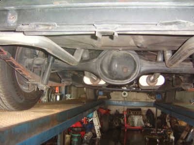

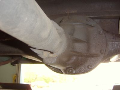

I Have a 1946 chevrolet sedan delivery with this rear in it. I need to change it to a hwy gear. Someone said it's a 1954. What can I use to do this.

Hi mike, a 370 -37/10 its a turbo 350 tran. need a hwy gear.

Thats an old "drop out" style rear end, not a 10 bolt. The gear you have is 3:70's. You would probably be good with a 3:08, you may only be able to go so far with tegear ratio, depending on the posi or diff, which ever it has. Im not sure where you are, but J&S Gear co. In Huntington Beach, Ca is really good and have been in business since the 60's. They have a very knowledgable staff, and can find just about anything
