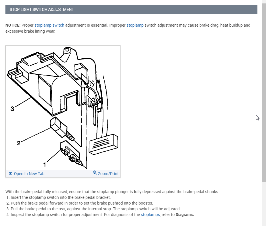

My brake lights work off and on because of the multi function control arm What is involved with fixing it? Thank you so much for any assistant. TLW

the brake lights are independent. and are on a seperate circuit. they work of the brake light switch on the brake pedal. With them working spartic check the power going to the switch. You could have a bad switch.

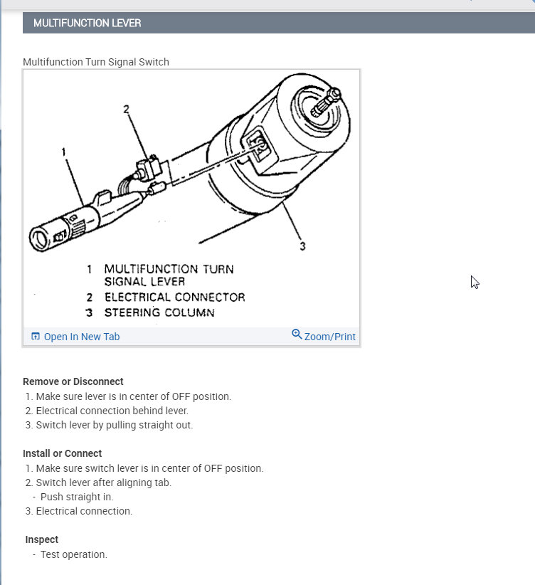

I attached the info on how to replace the multi function switch but this controls the turn signals and bright light on/off switch it does not control the brake lights. I suspect your issue is the brake light switch is out of adjustment. I attached the process on how to adjust this. Let me know if you have questions and how you make out. Thanks

I have to manipulate my turn signal lever to get my brake lights to work. What can I do about this? The 8th digit of the VIN is "M". The vehicle is listed above LS model. Will I have to remove the steering wheel to repair this problem? If so, how do I go about this?

It sounds like the switch is bad. Yes, the steering wheel needs removed to repair this. Before you do anything to the vehicle, disconnect the battery and wait about 30 minutes to make sure the air bag won't deploy when working on it. Then you simply need to remove the steering wheel assembly to access the switch.

We just fixed the same problem and dont ask why but gm runs the brake lights thru the turn signal we replaced the turn signal switch and no more problems was not easy but the part was 60.00 at auto zone
