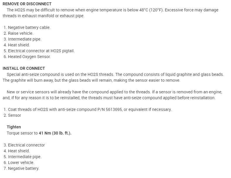

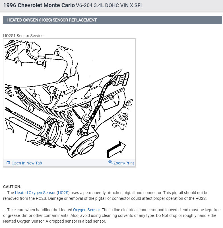

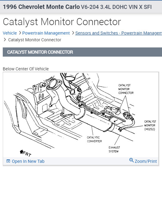

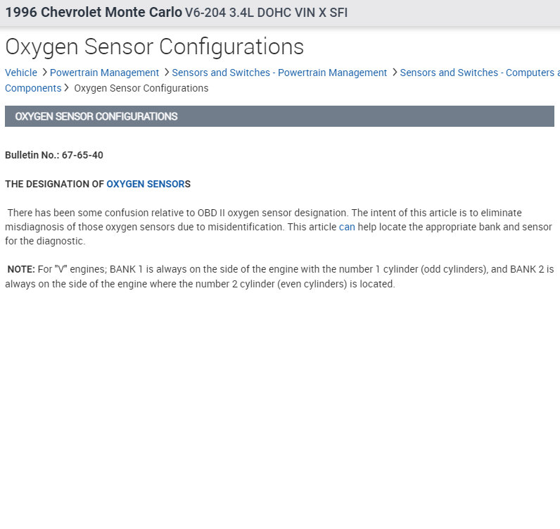

It has the 3.4. And i know there's two oxygen sensors, the upper and lower. I can find the lower behind the converter, but where is the upper located? I know it's in front of the catalytic converter somewhere, but where???
Mar 6, 2010 at 3:02 PM
SQM
  • CAR REPAIR CONTRIBUTOR
  • 6,383 POSTS
There are two upstream (upper) oxygen sensors. One in each exhaust manifold. They could be little difficult to see due to several components that can block the view.
https://www.2carpros.com/articles/how-to-replace-an-oxygen-sensor
