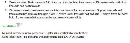

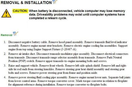

I need a diagram to show me how to replace my transmission on my car do u have one what I and copy and use?

BLUELIGHTNIN6
MECHANIC
16,542 POSTS
Wednesday, February 10th, 2010 AT 7:47 PM
