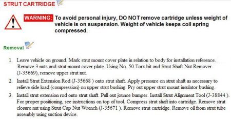

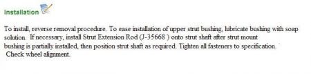

How do you change front shocks

Has struts on front not shocks
