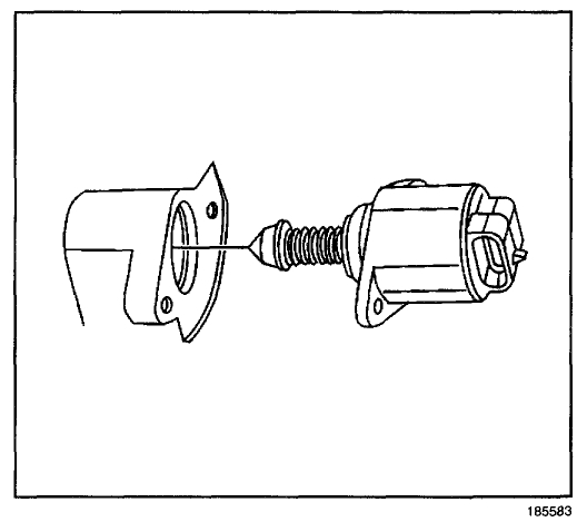

When I crank my car it catches the stutters and dies. Can you tell me what may be wrong with it?

It sounds like you have a vacuum leak or the throttle body needs cleaning. Here are three guides to help us.

Car starts and runs fine except it will die if foot is removed from accelator. With control of the accelator, I can get the RPMs down to 600 RPM. There is no check engine light "on".

Inspect and test the idle air control valve and throttle position sensor, PCV and EGR valves-

It was the dirty throttle bore. Thanks

Car turns over and starts, but it will not stay running.

Clean the throttle body and idle air control valve. The valve is attached on the throttle body. If that does not work then replace the idle air control valve.
