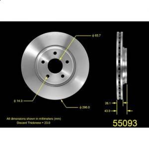

Well this is not so much a repair question but a brake related question still, I was replacing the front rotors on an 04 chevy malibu today, when I removed the old rotor and compared it to the one bought from autozone the new rotor was not the proper size it was to bid in diameter. So I took it back and got a second set this time for the malibu 'classic' they assured me they were the proper ones, which was good cause it was mu only other option. Took them matched them to the old rotors and they were the proper size but lug holes do not align properly, as such they do not fit onto the car. Any suggestions on why we cant find the proper rotors or where to look?

https://www.2carpros.com/forum/automotive_pictures/46384_8_1.jpg
it should look like this one.
does the one you got look defferent?

These are the ones we purchased originally they are bigger then the originals, the caliper mount does not fit over these

Part Number: 55093
Weight: 17.205 lbs
Warranty: 2 YR
Rotor Outside Diameter: 296 mm.
Height: 43 mm.
Bolt Hole and Circle Diameter: 5-110 mm.
Are your calipers original too?
