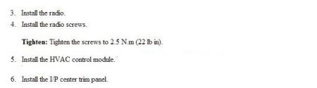

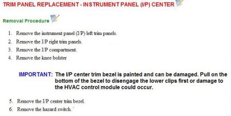

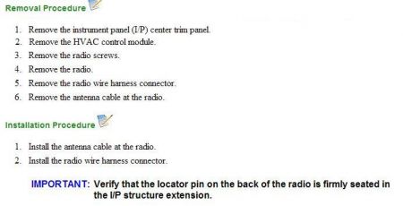

I am confident that I have a cd stuck in my cd changer. I just need to know step by step how to actually remove/disconnect the dashboard or the radio so that I can remove the cd?
thanks!
Tuesday, December 29th, 2009 AT 1:47 PM
BLUELIGHTNIN6
MECHANIC
16,542 POSTS
Saturday, February 27th, 2010 AT 9:37 PM
