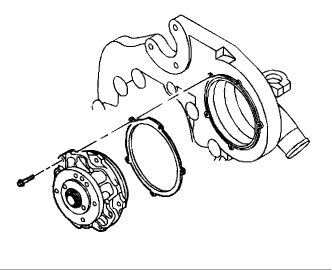

2003 Chevy Malibu 6 cyl Front Wheel Drive Automatic
how do you replace and remove the water pump

Water Pump Replacement Removal Procedure
https://images.2carpros.com/forum/automotive_pictures/12900_w1_4.gif
Drain the cooling system. Loosen the water pump pulley bolts. Remove the drive belt.
https://images.2carpros.com/forum/automotive_pictures/12900_w2_4.gif
Remove the water pump pulley bolts and pulley. Remove the water pump bolts, pump and gasket. Clean the water pump mating surfaces. Installation Procedure
https://images.2carpros.com/forum/automotive_pictures/12900_w3_4.gif
Install the water pump gasket and pump (1). Notice: Refer to Fastener Notice in Service Precautions. Install the water pump bolts. *Tighten the water pump bolts to 10 Nm (89 inch lbs.).
Install the water pump pulley and bolt until snug. Install the drive belt. Tighten the water pump pulley bolts. *Tighten the water pump pulley bolts to 25 Nm (18 ft. lbs.) . Fill the cooling system. Inspect for leaks. https://www.2carpros.com/kpages/auto_repair_manuals_alldata.htm
