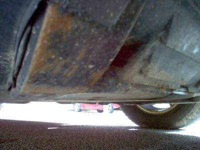

Sorry it took so long; I decided to try and take pictures to give you an idea of what I saw that might be the culprit.
https://images.2carpros.com/forum/automotive_pictures/346277_IM000154_1.jpg

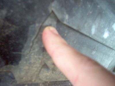

Here is one thing I found interesting. This is actually behind the air dam, on the right front side of the car. There is a hairline crack there, and the piece feels loose towards the bottom.
https://images.2carpros.com/forum/automotive_pictures/346277_IM000148_1.jpg
(just me pushing on that area where I saw the crack)

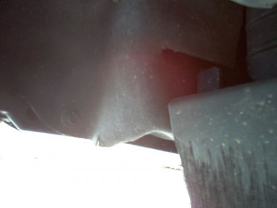

This is in front of the air dam, on the right side. I noticed the material didn't seem to be as secure as on the left side.

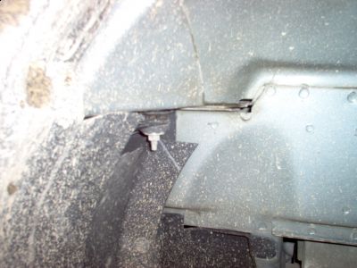

This is the only other weird thing I came across; this is on the driver side front wheel well. The material comes up and is just cut off to make room for the nut and screw. Thanks.

In the wheel well There should be a black plastic molded piece that goes from front fender across top of tie and down to bottom of well . I did not see that in your photo the last one. you should not be seeing the painted inside of fender. Water comming off tire and hitting metal would make big noise ie. metal roof

So to make sure we're on the same page, your concern is with the driver side wheel well, where that screw and nut are, and the black part is cut off/looking weird? That's the only place where the two wheel wells aren't identical (both sides have the black plastic arching around the well, but the passenger side piece is whole, and not awkward-looking like this one in that spot). I can try and take more pictures sans a flash if that is needed (or if there's something else you need to see).
