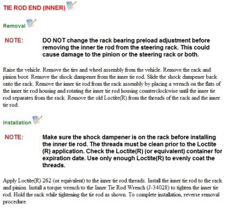

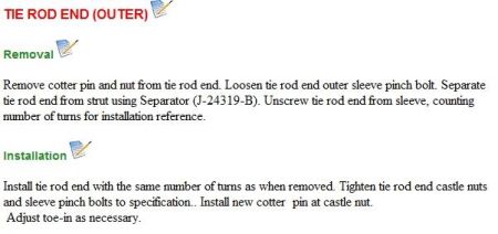

HOW TO CHANGE FRONT TIRE RODS ON A 02 CHEVY MALIBU?
Thursday, April 29th, 2010 AT 10:39 AM
BLUELIGHTNIN6
MECHANIC
16,542 POSTS
Friday, April 30th, 2010 AT 12:38 AM
