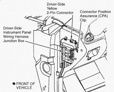

I changed the fuse and the turn signals are still cutting out. I think it might be the relay. Where do I find the relay on a 2001 chevy malibu? If that doesnt work what else could be wrong?
Saturday, September 27th, 2008 AT 9:16 PM
11 Replies
RHALL77
  • 3,361 POSTS
The relay is built into the hazard switch in the dash
Its not the best picture, but there is one attached below
+1

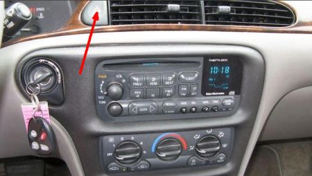

How do you replace the emergency flasher switch/flasher unit on a 2001 Malibu. How do you remove the dash trim piece without breaking it and does the unit itself just "snap" in or is there a "trick" to get the old one out and the new one in? Thanks.
https://www.2carpros.com/forum/automotive_pictures/397929_2001dash_2.jpg

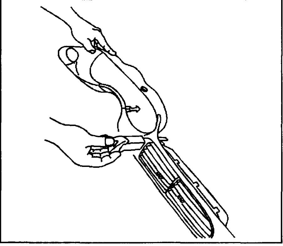

Here are instructions on how to remove the switch:
INSTRUMENT CLUSTER TRIM PANEL
Removal 1. Disable Supplemental Inflatable Restraint (SIR) system. See appropriate AIR BAG RESTRAINT SYSTEMS article.
2. Remove screws from lower steering column trim cover.
3. Remove upper steering column trim cover from steering column.
4. Remove screws from instrument panel cluster trim plate.
5. Gently pry out instrument panel cluster trim plate form instrument panel carrier with a small flat-bladed tool.
6. Remove instrument panel cluster trim plate from instrument panel carrier.
7. Disconnect electrical connector from instrument panel dimmer switch.
8. Disconnect electrical connector from hazard warning switch. Installation
https://www.2carpros.com/forum/automotive_pictures/62217_1_33.jpg
https://www.2carpros.com/forum/automotive_pictures/62217_2_31.jpg
