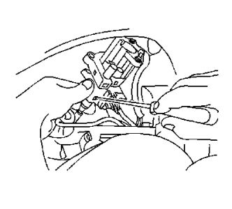

Ignition Lock Cylinder:
Removal & Installation
1.Remove the knee bolster.
2.Turn ignition switch to the RUN position.
3.Push the ignition lock cylinder tab.
4.Remove the ignition lock cylinder.
https://www.2carpros.com/forum/automotive_pictures/377707_32107_mali_g0104_1.jpg
The removal and installation of the ignition lock cylinder

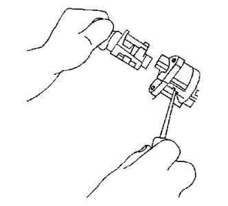

https://www.2carpros.com/forum/automotive_pictures/377707_2a_3.jpg
Remove the bolts from the ignition switch
8.Remove the bolts from the ignition switch.

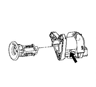

https://www.2carpros.com/forum/automotive_pictures/377707_2b_2.jpg
Disconnect the electrical connectors from the ignition switch
9.Disconnect the electrical connectors from the ignition switch.

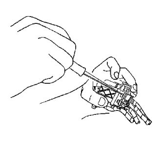

à † Locate the surface for the lock cylinder release button (2) on the plastic ignition switch housing. Center punch a location on the rib (1) approximately 3/8 inch rearward toward the key entry end from the cylinder release button.
à † Carefully drill a pilot hole through the plastic housing with a 1/8-inch drill bit.
à † Using a 9/32-inch drill bit, carefully drill a larger hole at the pilot location, and slightly into the surface of the ignition switch lock cylinder to break the release button retaining spring .
à † Remove portions of the broken spring from the hole using a small suitable tool.
à † Grasp the ignition switch lock cylinder and remove the cylinder from the switch housing.
à † Remove any plastic flashing from the drilling operation. Use compressed air to blow out the ignition switch assembly.
à † Follow service procedures when cylinder recoding is required.
https://www.2carpros.com/forum/automotive_pictures/377707_2c_2.jpg

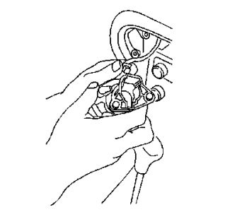

Depress and release the transaxle park/lock cable retainer. Pull to remove the park/lock cable from the ignition switch
12.Depress and release the transaxle park/lock cable retainer. Pull to remove the park/lock cable from the ignition switch.
https://www.2carpros.com/forum/automotive_pictures/377707_2d_1.jpg
Press the release plunger on the ignition switch lock cylinder. The release plunger is located at the four o'clock position on the ignition switch housing
13.Press the release plunger on the ignition switch lock cylinder. The release plunger is located at the four o'clock position on the ignition switch housing.
14.Use the key in order to pull the lock cylinder from the ignition switch housing.

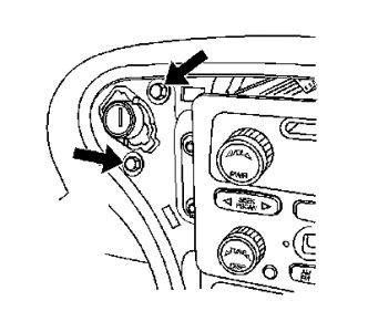

https://www.2carpros.com/forum/automotive_pictures/377707_2e_1.jpg
Disconnect the pass key electrical connector from the ignition switch housing
15.Disconnect the pass key electrical connector from the ignition switch housing.
16.Remove the ignition switch from the vehicle.
