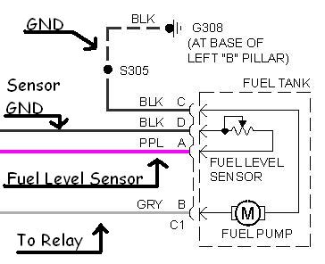

Do you have a wiring diagram for the electric fuel pump in the tank. I would like to make sure the pump is bad. I can not here the pump go on or no pressure at all. I would like to hot wire the pump to see if it is bad or good,
