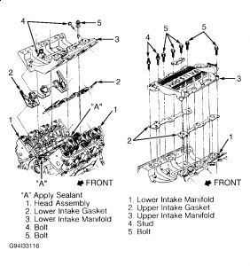

BMRFIXIT
  • CAR REPAIR CONTRIBUTOR
  • 19,053 POSTS
Coolant leak !! very common for the lower intake manifold gasket to be leaking you take the upper to get to the injectors injectors site on top the lower intake manifold balance test can be done using a scanner leak test need fuel pressure gauge check fuel pressure after engine of if pressure drop quickly or not ***************************************** need manual CHECK IT @ https://www.2carpros.com/kpages/auto_repair_manuals.htm
https://images.2carpros.com/forum/automotive_pictures/99387_Graphic1_356.jpg

HSOBCHINSKY
  • 5 POSTS
Well I finally took your suggestion and tore down the engine. What I found was lower intake gasket split and leaking just above the trans bell housing and decided to pull the rear cylinder head off also. What i found there was I think cylinder #2 definately is burning coolant, this cyl. is extreamly clean and wet compared to the other two that have carbon build up.
I could not find where the coolant is entering from, I inspected the Head, Gasket and Cylinder walls. The only suppision I have is a vertical white line on the cylinder wall and I sent a pic.
What I don't understand is before the tear down I did a pressure test on all cylinders and they all held pressure about (100 psi) for about 2o minutes each. How can I find where the coolant is coming from.
