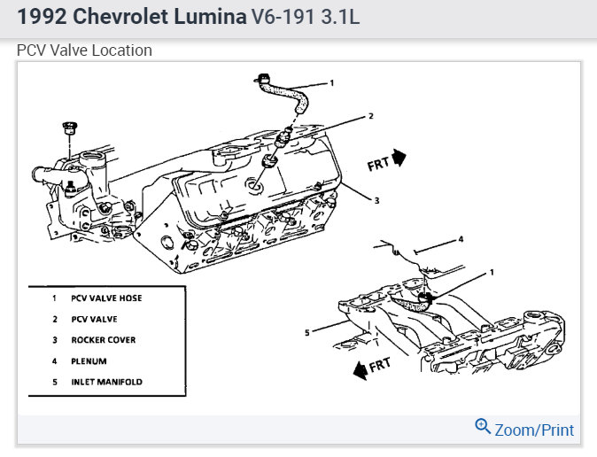

I am trying to find out where on the 3.1 motor on a 1992 Chevy Lumina I would find PCV valve. The car is missing, already cleaned out fuel injection and hose going to air filter due to black looking oil in it, and car ran good. Today the car started missing again and was explain to me it could be the PCV valve is bad but can't find it on my car. Need help locating PCV valve.

Pretty sure that is in the rear valve cover, should have a line going to the intake manifold. Has the car been tuned up recently? Check out the diagrams (Below). Please let us know if you need anything else to get the problem fixed. Cheers

Right side of intake coming off the manifold. There will be another line directly below it, seafoam or deepcreep that line as well. You may as well take your intake off and spray deepcreep into the manifold while you're at it. Dont just clean one spot at a time, do the whole thing. New pcv valve is only a couple bucks. If it continues to miss, let us know and we'll try something else.
