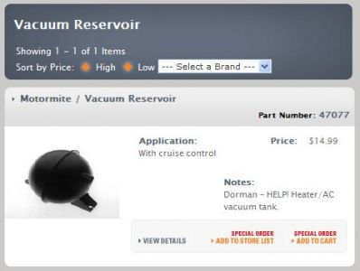

While driving down the road today a black ball fell off from under the car. I think it was the Vacuum Ball. (Don't know if that is the right name for it.) Where can I find a replacement? What does it do and is it really needed?
Wednesday, April 29th, 2009 AT 4:05 PM
BLUELIGHTNIN6
  • 16,542 POSTS
I believe you are talking about the vacuum resevoir..it is used for part of the HVAC (heating, ventilation and A/C) system's vacuum. Pricing is below for the part found on AutoZone.com .
https://www.2carpros.com/forum/automotive_pictures/261618_Noname_497.jpg
