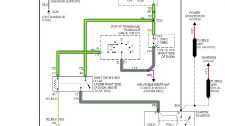

Thank u in advance. My car wouldnot start when I turn the keys. All lights comes on fine. But just wouldnot turn over. Alreadychange starter, still the same problem. New battery and alternator. Just dont know what to do.

Check neutral safety switch mounted on he starter
do you have or had an alarm check the wiring also is your security light on or blinking it may be the key leave it in the ignition turn on for few minutes and then try

Get a regular house wire no.12 AWG and jump the battery terminal on the starter with the small terminal with a purple wire-did it kick over-if not have helper hold key to start position and look for power at purple wire-do you have power. Also see below for additional components involved.
https://www.2carpros.com/forum/automotive_pictures/12900_stat3_1.jpg
https://www.2carpros.com/forum/automotive_pictures/12900_stat2_1.jpg
https://www.2carpros.com/forum/automotive_pictures/12900_stat1_1.jpg
