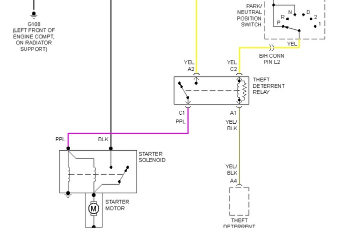

This car has what seems to be typical occasional no start problems that seem to be in the security system. Switch and keys have been changed in the past few years. I occasionally clean keys and switch with electronic cleaner. Sometime when this condition occurs, the security light on dash does not light during key on pre-start. Anyone found a solution to this or can the security system be wired around in a relatively simple way? Thanks in advance. Mike D

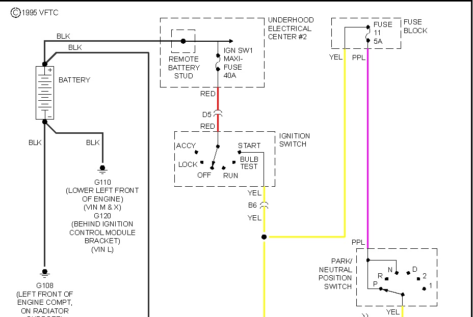

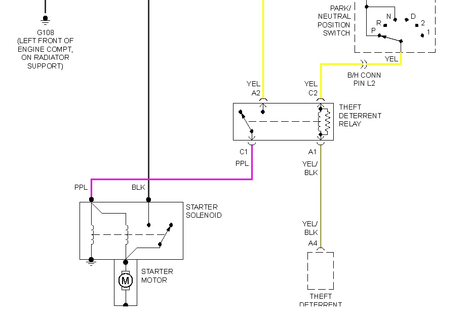

JDL
  • 16,098 POSTS
Is there a pellet in the key? There is information all over the web about bypassing that pellet, but, if the problem is elsewhere in the security system, that bypass will not work.
You could use a remote starter button on the starter solenoid, to see if it will crank? The leads on mine are not long enough to get me away from the vehicle, You have to be sure the transmission is in park or neutral and a functional e-brake is set. Even if you can crank it, if security issue, it still will not start, because of fuel enable.
Below is wiring for your starter.

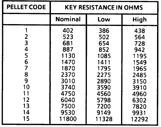

WRENCHTECH
  • 20,761 POSTS
Here is what you need, but as JDL stated, this will only resolve an ignition key sensor issue. The rest of the system has to be working and cannot be bypassed.
The most common failure in these is the sensor in the ignition lock that reads the key pellet. That would mean replacing the ignition lock with a sensor included.
That sensor can be bypassed. You would need a digital ohmeter to measure the resistance of the pellet in the key. Now go to Radio Shack and buy a resister of the exact same value as the key pellet. Go to the base of the steering column and locate the two thin white wires that go up to the sensor. Cut the two wires and solder the resister between the two ends coming from the harness. This will permanently bypass the sensor but not the rest of the system.
Below are the key resistance choices.
