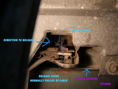

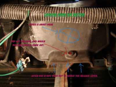

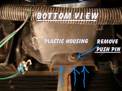

I have had this van a few years now and recently the cable to release the got broken. Can I open the hood manually somehow? Thanks
