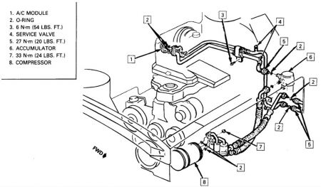

My brother has the knowledge and the equipment to add freon to my husband's 92 Chevy Lumina, but they can't find the "plugs" I think they are called, to add it into. Can somebody tell me where they are? THANKS

Service Port HVAC Refrigerant Lines And Routing
https://images.2carpros.com/forum/automotive_pictures/12900_sp_13.jpg
