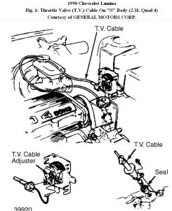

Where is the TV cable located and how do you replace it my lumina euro is having hard shifts and hopefully this will be a fix to the problem any suggestions?

I am not sure which engine variant you have and replacement requires the oil pan to be dropped. It leads from the accelerator throttle linkage to the transmission.

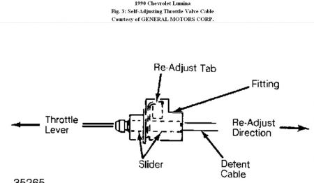

Before you replace the cable , check that it is not binding nor broken and perform adjustment first. An out of adjustment TV cable can cause harsh or erratic shifting.
Here are some diagrams for you to understand the system.
https://www.2carpros.com/forum/automotive_pictures/192750_TVCable90LuminaFig01_1.jpg

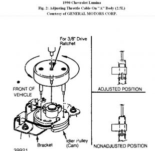

https://www.2carpros.com/forum/automotive_pictures/192750_TVCable90LuminaFig02_1.jpg
https://www.2carpros.com/forum/automotive_pictures/192750_TVCable90LuminaFig03_1.jpg

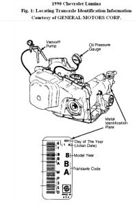

Thanks for the response you guys are awesome. Do u have the diagrams for a 3.1 liter motor the model I have is the 4 door 1990 Lumina Euro 3.1 with Automatic Trans. And also I am trying to replace the modulator valve but I cant seem to find any imformation on it can you send the diagram for that too and any suggestions you may have? Thanks so much I tell all my friends about yalls site yalls information saves me $$ at the mechanic. How do you get those diagrams?

Use the 3rd diagram for adjustment.
1. Engine must be off. Depress metal readjust tab on cable adjuster (located at cable support bracket on engine) and hold it in this position.
2. Move cable housing slider (away from throttle lever) until it stops and is completely against fitting. Release readjust tab. See Fig. 3 .
3. Rotate throttle lever (by hand) to its full throttle position. Slider must move (ratchet) toward lever when lever is rotated to its full throttle position. Check cable for sticking and binding.

https://www.2carpros.com/forum/automotive_pictures/192750_TranIden90LuminaFig01_1.jpg
For the diagram shown, the modulator valve is where the vacumn gauge is attached, it is blocked from view. There should be a vacumn hose attached to it.
Before replacing the modulator, test it for vacumn leakages to ensure the diaphragm is good.
