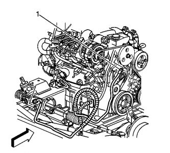

trying to flush the power steering fluid, and the documentation says to remove the power steering fluid return hose - where is it? Help greatly appreciated. I have sucked what fluid I could out already, but it was less than 12 oz. I just obtained the car from a guy who drove it 300 miles a day, so am changing all the fluids and filters.
May 28, 2010 at 7:21 PM
  • 75,992 POSTS
See location no.1
https://images.2carpros.com/forum/automotive_pictures/12900_ps_4.jpg

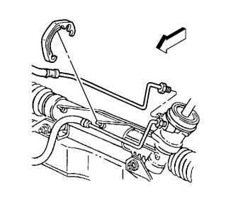

Dear Sirs,
I need to replace the high pressure power steering hose on my car is has a 3.4 liter engine. I need to know how difficult it will be and if you have a diagram of how to do it and what needs to be removed?

Here is what I have from GM service information. Power steering pressure pipe/hose replacement (3.4L). Removal procedure: Place a drain pan under the vehicle.
https://images.2carpros.com/forum/automotive_pictures/309872_515071_1.jpg
Remove the power steering pressure line from the power steering pump. Remove the power steering pressure line from the power steering lines retaining bracket on the engine.
https://images.2carpros.com/forum/automotive_pictures/309872_417973_1.jpg
The power steering pressure line is the lower line at the power steering gear. Remove the power steering line from the power steering gear . Access the line from the engine compartment, between the rocker arm cover and the front of the dash mat. Raise and suitably support the vehicle. Refer to Lifting and Jacking the Vehicle in General Information.
https://images.2carpros.com/forum/automotive_pictures/309872_469241_1.jpg
Remove the power steering pressure line (1) from the clamps on the power steering gear. Remove the power steering pressure line (1) from the vehicle. Installation Procedure
https://images.2carpros.com/forum/automotive_pictures/309872_469241_2.jpg
Install the power steering pressure line (1) to the vehicle. Install the power steering pressure line (1) to the clamps on the power steering gear. Lower the vehicle.
https://images.2carpros.com/forum/automotive_pictures/309872_417973_2.jpg
Notice: Use the correct fastener in the correct location. Replacement fasteners must be the correct part number for that application. Fasteners requiring replacement or fasteners requiring the use of thread locking compound or sealant are identified in the service procedure. Do not use paints, lubricants, or corrosion inhibitors on fasteners or fastener joint surfaces unless specified. These coatings affect fastener torque and joint clamping force and may damage the fastener. Use the correct tightening sequence and specifications when installing fasteners in order to avoid damage to parts and systems. Install the power steering pressure line to the power steering gear. Tighten Tighten the power steering pressure line fitting to the power steering gear to 27 N ·m (20 lb ft). Install the power steering pressure line to the power steering lines retaining bracket on the engine.
https://images.2carpros.com/forum/automotive_pictures/309872_515071_2.jpg
Install the power steering pressure line to the power steering pump. Tighten Tighten the power steering pressure line fitting to the power steering pump to 27 N ·m (20 lb ft). Fill the power steering system with power steering fluid. Refer to Checking and Adding Power Steering Fluid . Bleed the power steering system. Refer to Power Steering System Bleeding . Inspect the power steering system for leaks. Refer to Power Steering Fluid Leaks .

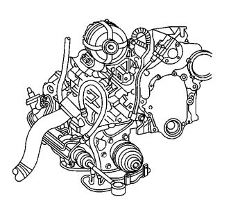

HARRY65
my power steering return line is split and I need to know the best way to remove it . i was told it had to come out the wheel well. i dont like that sloution. this is the line that wraps around the engine. it feeds the rack and pinion i believe and goes around the front of the motor.
Jun 20, 2020 at 10:53 AM (Merged)
HMAC300
  • 48,601 POSTS
see pics
