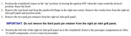

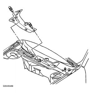

How do I remove the retainers on the cowl, to replace the passenger side air filter. ( Is there a tool required)
