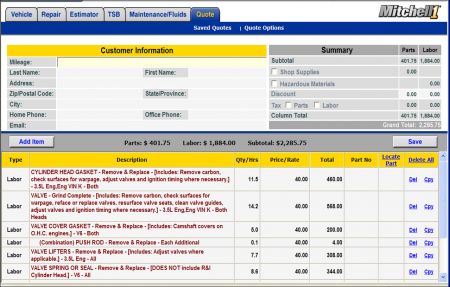

You might still consider getting it and doing the test just so you have a good idea.
If I were going to do this I would do both sides, make sure the heads are surfaced and they check the valves, and replace any seals etc since it is all apart.
It seems that the 3.5L possible has a difference if your VIN, 8th digit is a K or an N but should be able to get close.
https://www.2carpros.com/forum/automotive_pictures/248015_Picture1_108.jpg
From what I see possible between $2000-$2600. Now if it is a little more that is okay as long as it is close. They may run into some things, more bent valves, etc. . ..other shop stock used. Just discuss the cost and what they do ahead of time.
Also, make sure they surface the heads. I am working with another that it appears that they had a head gasket repair and 8 months later the same problem. Most likely the head was warped, it wasn't surfaced and all they did was gasket off and new on.
