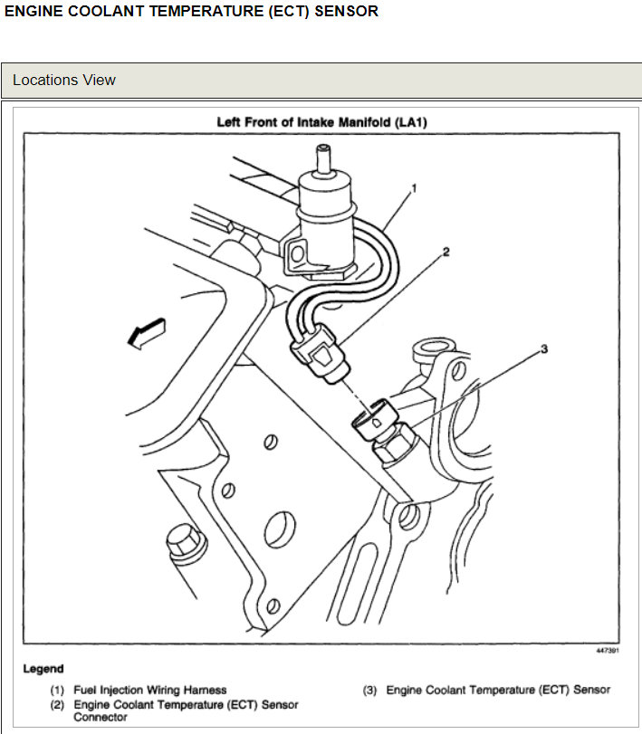

Where is it located? Can it be easily removed and replaced?

Here is a guide to help you see what you are in for when doing the job.
https://www.2carpros.com/articles/coolant-temperature-sensor-cts-replacement
Here is the location on your car.

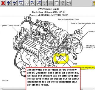

How do you change your coolant sensor, or where can I find out how to go about doing so?

I have a diagram with the simple instructions and location of the ect, (engine coolant temp sensor)

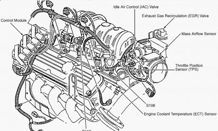

Where is the Engine coolent sensor located?

On 3.8 As in diagram:

Engine coolant temperature (ECT) sensor is located near the coolant outlet, on left rear of engine.
