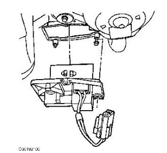

Just noticed that my fan doesn't work in the first 2 speeds, but works fine 3, 4, &5. Could the problem be a fuse for the lower fan speeds?

Hello !
Check the blower fan resistor, that should solve your problem!
The blower motor resistor its located on HVAC module, below blower motor.
Let us know if you need a picture of it!
Good luck!

As your request (e-mail) here`s the schematic of the blower motor resistor location:
https://www.2carpros.com/forum/automotive_pictures/576_0_14.jpg

Is this located under the glove box or under the hood?
