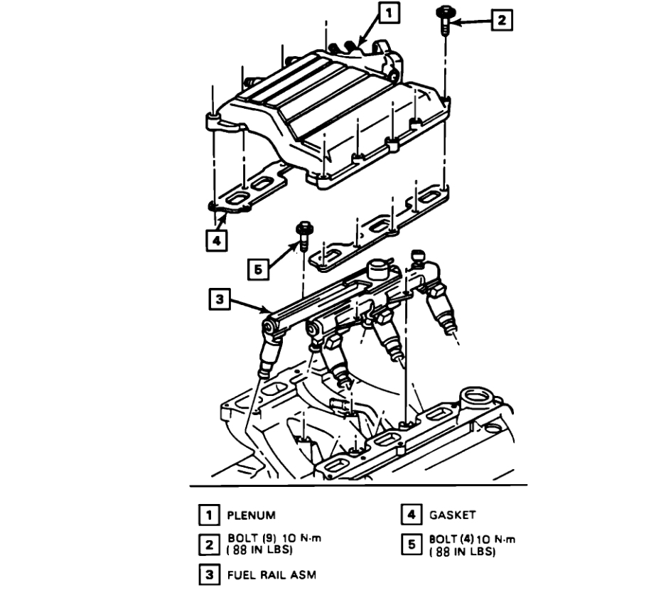

I replaced the crank sensor and the car started fine, but the check engine is still on. I check for codes but no codes and only I have little bit white smoke from exhaust. What is the problem? I don't know what to do with this check engine light.

Good job, the plug with the black carbon can be from a stuck fuel injector which can cause white smoke as well. Here is how to check the fuel injector:
https://www.2carpros.com/articles/how-to-test-a-fuel-injector
Which cylinder had the black plug?

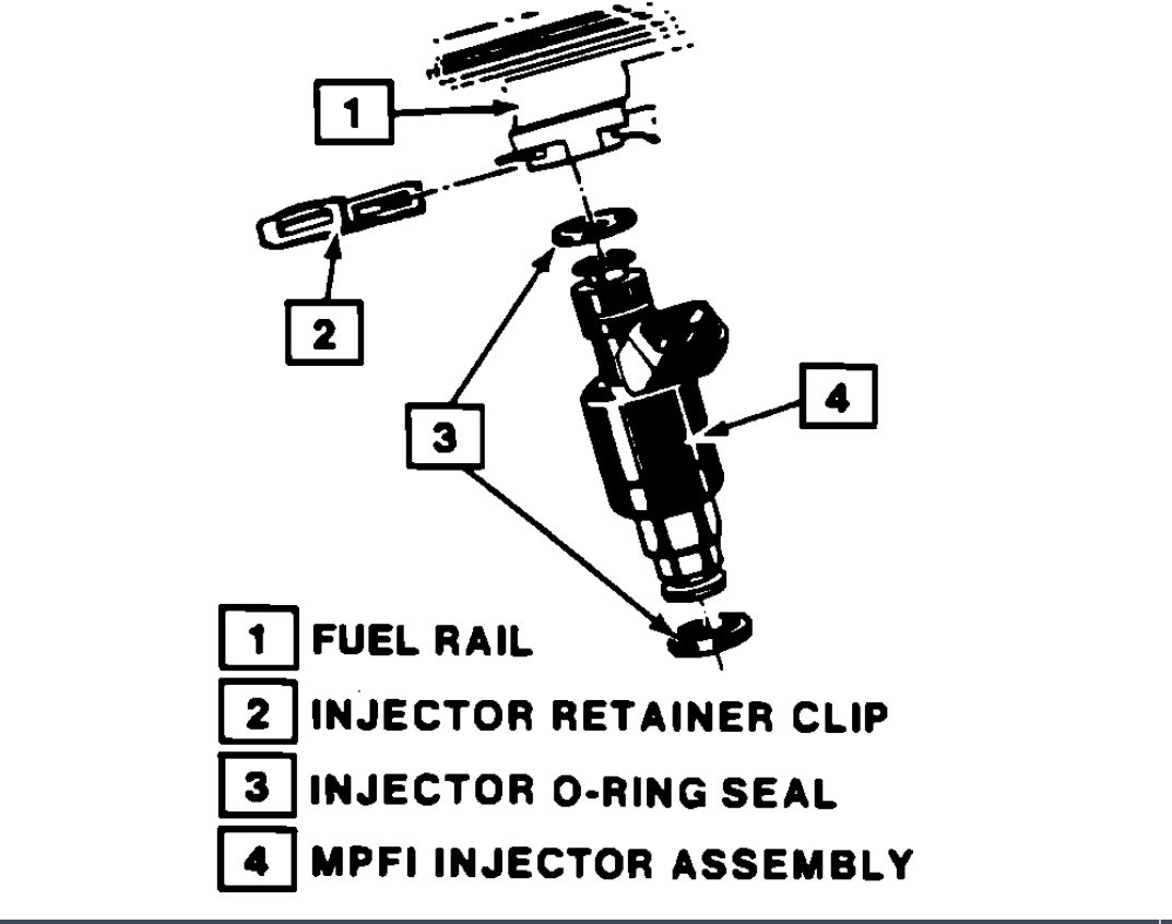

Yes, that's a sign you have a stuck fuel injector. Did you check for a blown head gasket? Also does the engine use coolant. Here is how you can remove the injectors for testing, check the diagrams below:
REMOVE OR DISCONNECT:
NOTE: Use care in removing injectors to Prevent damage to the electrical connector pins on the injector, and the nozzle. The fuel injector is serviced as a complete assembly only. Since it is an electrical component, it should not be immersed in any type of cleaner.
1. Negative battery terminal.
2. Relieve fuel system pressure.
3. Intake manifold plenum.
4. Fuel rail assembly.
DISASSEMBLE:
1. Injector retainer clip and discard.
2. MPFI injector assembly.
3. Injector O-ring seals from both ends of injector and discard.
IMPORTANT: Each injector is calibrated for a specific flow rate. When replacing fuel injectors, order replacements with the identical part number as the old injectors.
ASSEMBLE:
1. Lubricate new injector O-ring seals with clean engine oil, and install on injector assembly.
2. New injector retainer clips on injector assembly. Position open end of clip facing injector electrical connector.
3. MPFI injector assembly into fuel rail injector socket with electrical connectors facing outward. Push in far enough to engage retainer clip with machined slots on rail socket.
INSTALL OR CONNECT:
1. Fuel rail assembly.
2. Intake manifold plenum.
Monday, June 6th, 2022 AT 12:57 PM

Is it possible to check the injector with no remove all? I don't want to remove all for nothing.
Tuesday, June 7th, 2022 AT 8:05 AM
KEN L
  • MASTER CERTIFIED MECHANIC
  • 55,266 POSTS
You can try it one at a time and then stop if you find a bad one.
