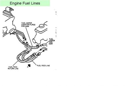

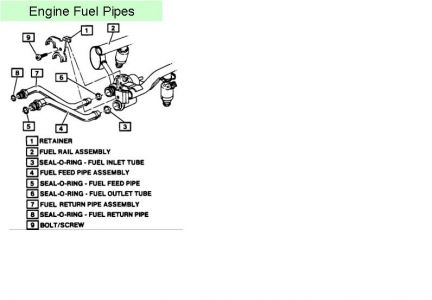

where does the gas hose conect to the engine
Wednesday, September 24th, 2008 AT 8:51 AM
IMPALASS
MECHANIC
3,112 POSTS
You didn't say if it was a 4 or 6 cyl
this is for a 6 cyl
