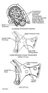

How do you line up the timing marks?

Hi there, I hope that this helps.
