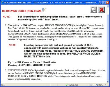

My Corsica has just started having this problem within the last few months. If we drove for more than a few miles, we would turn the car off and then if we waited about 15 minutes, the car would not start. When I left the car to cool completely off, we could start it again. We have had the fuel filter replaced, the oil sensor replaced, and the fuel injection cleaned, and nothing has helped. Now it will not start at all. Is there anything you can suggest short of having it hooked up to computer? Thanks!

https://www.2carpros.com/forum/automotive_pictures/416332_1991_chevy_corsica_retriving_codes_part1_1.jpg

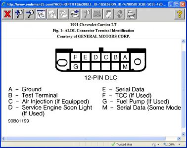

https://www.2carpros.com/forum/automotive_pictures/416332_1991_chevy_corsica_retriving_codes_part2_1.jpg
There's how you get the code's with out a computer give that a try.Also does it crank no start or no crank no start?
