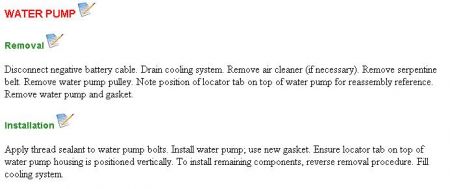

Does anyone have tear down instructions on how to replace water pump?
Thanks so much, Rayne

Our instructions are meant for seasoned technicians, so this is all I have.
You are better off going to your local part store and purchase a Haynes 24032 manual for your vehicle.
