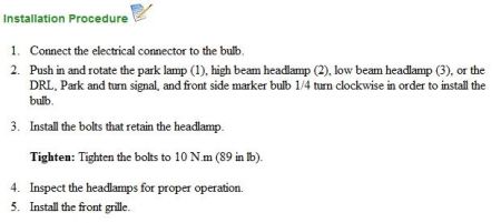

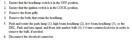

HOW DO WE REPLACE THE DRIVER SIDE HEADLIGHT, IT IS FOGGING AND NEEDS TO BE REPLACED
