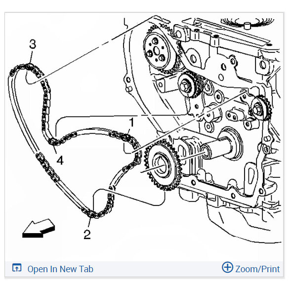

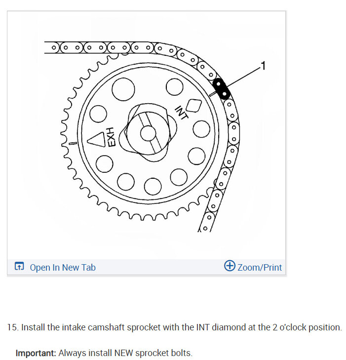

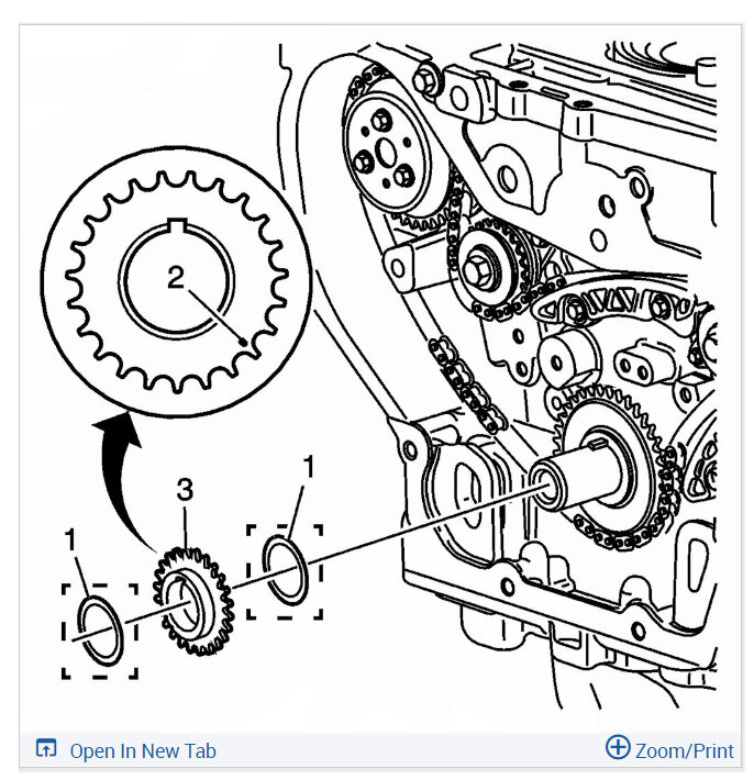

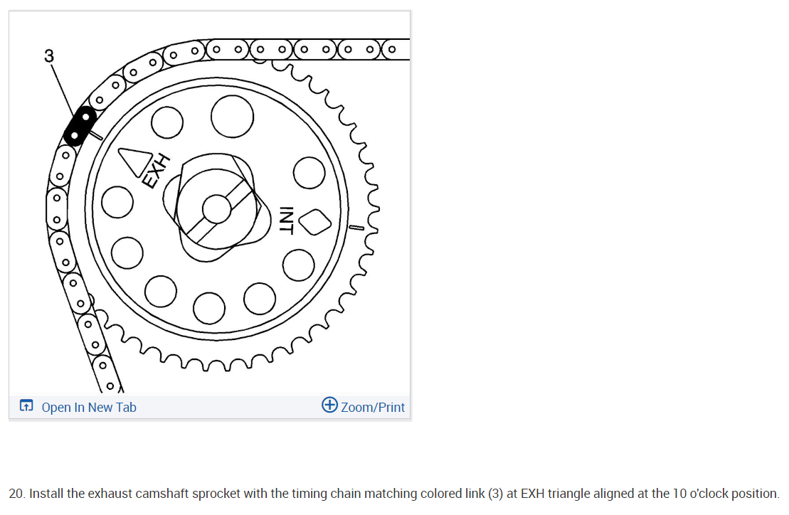

My cams are in time. Not sure how to get crank where I need it. How do I set the crank?
Saturday, November 17th, 2007 AT 3:54 PM
BMRFIXIT
  • 19,053 POSTS
No problem here is the camshaft to crankshaft timing marks to help you put the engine back together. Check out the images (below). Let us know if you need anything else.
