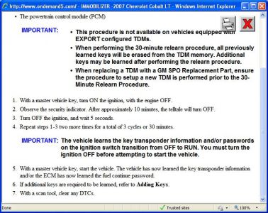

My cobalt's power steering kept going out and my dash light kept going crazy but when I turned off my car and restarted it, sometimes all the lights would go off and my steering would work. I had the power steering replaced due to the RECALL and my car still done the same thing. I bough a used computer out of another cobalt and installed it but now my car won't start. My questiong is: Does the computer need to be reprogrammed before my car will start and run again?

https://www.2carpros.com/forum/automotive_pictures/416332_2007_cobalt_passlock_learn_1.jpg
Did you replace the body control module computer? If so then yes for it to start you would have to relearn the pass-lock sensor. Give what I posted a try.
