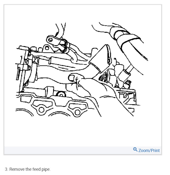

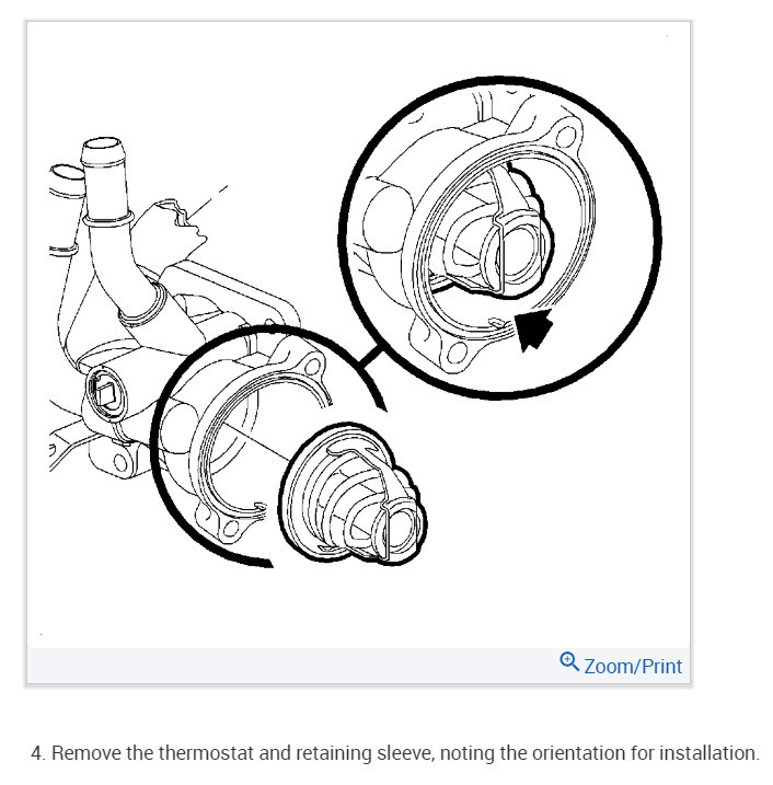

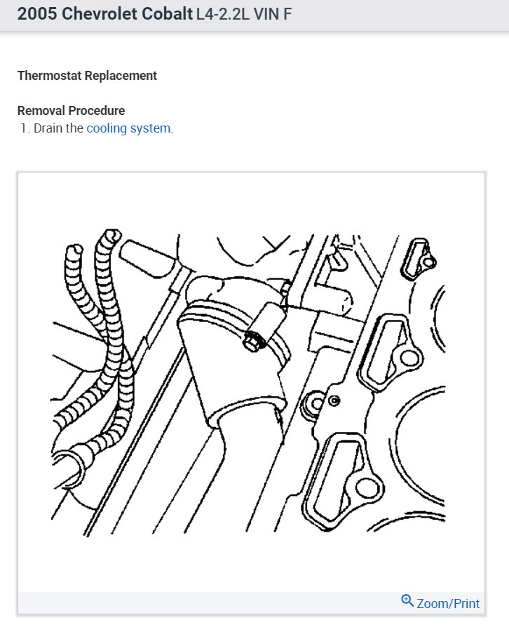

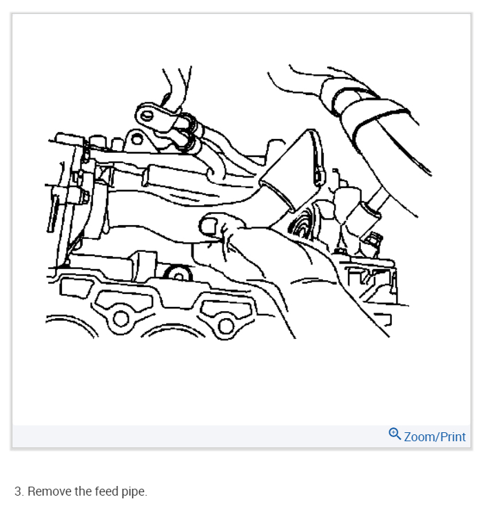

How to replace the thermostat, and where is located it?
Sunday, October 11th, 2009 AT 11:52 AM
3 Replies
BLUELIGHTNIN6
MECHANIC
16,542 POSTS
The thermostat is located near the bottom radiator hose. Here is a guide to help you see step by step and diagram below to show you the locations:

Where is the thermostat located? I cannot seem to find it.
Thursday, August 2nd, 2018 AT 5:51 PM (Merged)
DOCFIXIT
MECHANIC
18,828 POSTS
See a pipe coming off back of water pump? At the end of pipe see two bolts that is thermo housing. Remove and there is thermostat.
