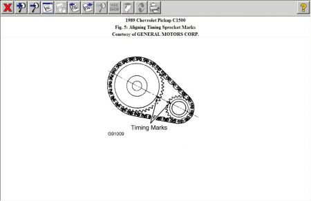

89 chev cheyenne 4.3 v-6 1500 2 wheel drive I need to have a diagram of the timeingset on it

If you're talking about the ignition timing you set it on 0/TDC at idle-but 1st you need to disconnect the EST bypass wire
