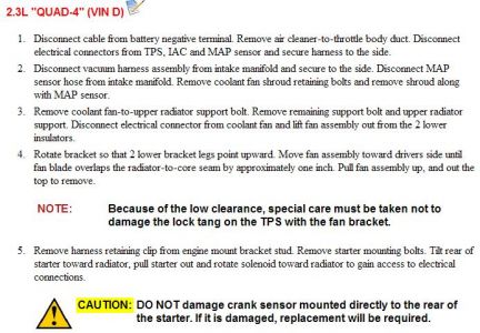

How to replace a starter and starter solenoid
Friday, November 27th, 2009 AT 8:12 PM
BLUELIGHTNIN6
MECHANIC
16,542 POSTS
-1
Friday, November 27th, 2009 AT 9:38 PM
