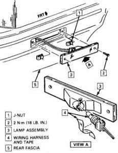

1987 Chevy Celebrity 6 cyl Front Wheel Drive 114000 miles
how to replace the rear turn signal bulb
Tuesday, January 26th, 2010 AT 6:38 PM
BLUELIGHTNIN6
  • 16,542 POSTS
Rear Turn Signal, Brake and Parking Lights
Remove the tail light assembly screws, then the assembly.
Disconnect the twist lock socket from the lens housing.
To remove the bulb, turn the twist lock socket (at the rear of the housing) counterclockwise1/4turn, then remove the socket with the bulb; replace the bulb if defective.
https://www.2carpros.com/forum/automotive_pictures/261618_1_103.jpg
To install:
Attach the socket assemblies to the back of the lamp unit.
Install the lamp assembly to the vehicle with the mounting screws.
