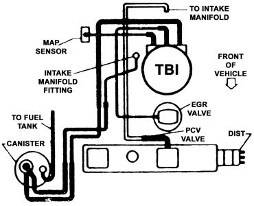

Could you point me in the right direction to find a diagram of the proper vacuum line configuration on a 1987 Chevy Cavalier 2.0 4cyl with a TBI?

I hope this works for you
http://www.2carpros.com/forum/automotive_pictures/75270_87_cavalier_tbi_guide_1.jpg
