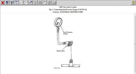

How do I check the pressure?

Use a fuel pressure gauge at the fuel test port on the fuel rail. Here is a guide to help you step by step with instructions in the diagrams below to show you how on your car.
https://www.2carpros.com/forum/automotive_pictures/12900_fp_check_1.jpg

What should the fuel pressure be. One place told us 65 psi another place told us 115. Which is it?

Key on engine off should read 50-60 psi. Here is a guided hat will help you see how to test the fuel pressure.

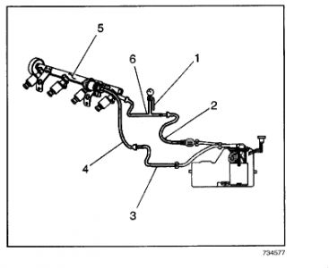

The vehicle was ran dry on fuel and with much attempt (yes it now has fuel) I cannot get it to run, all it will do is start for about 3 seconds and die everytime. I assumed the fuel pump could be bad but I had a helper turn the key on while I listened by the fuel tank. The pump is definatly running. I am now assuming there could be an air lock in the system but Im not sure where I can crack a line and bleed it. Your advice would be appreciated. Thankyou

https://www.2carpros.com/forum/automotive_pictures/12900_fp1_37.jpg
Relieve the fuel system pressure. Refer to Fuel Pressure Relief Procedure
Disconnect the fuel feed hose (2) from the fuel rail (5).
Install the J 29658-D with the J 29658-500 between the fuel feed hose and fuel rail.
Turn ON the ignition, with the engine OFF.
CAUTION: Refer to Fuel Storage Caution in Service Precautions.
Place the bleed hose of the fuel pressure gage into an approved gasoline container.
Open the bleed valve on the fuel pressure gage in order to bleed the air from the fuel pressure gage.
Command the fuel pump ON with a scan tool.
Close the bleed valve on the fuel pressure gage.
Inspect for fuel leaks.

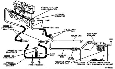

Where do you attach the fuel pressure guage yo check the fuel pump pressure?

No Fuel Pressure Test Port exists for this model/engine.
You must install an in-line gauge, as shown below to get pressure readings.
https://www.2carpros.com/forum/automotive_pictures/12900_fp_60.jpg

I need to know how to check the fuel pressure, there does not appear to be a schrader valve anywhere that I can find. So how do I hook a gauge up?

https://www.2carpros.com/images/external/41919968.gif
You must install an in-line gauge, as shown above, to get pressure readings.
