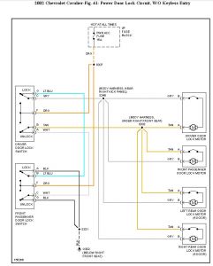

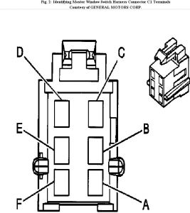

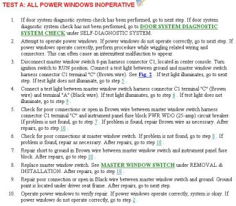

I would start off on the power windows, as the aftermarket system shouldn't affect that...maybe.
Besides it would be nice to have the windows over the locks anyways.
http://www.2carpros.com/forum/automotive_pictures/30961_capw_1.jpg
http://www.2carpros.com/forum/automotive_pictures/30961_capw1_1.jpg
http://www.2carpros.com/forum/automotive_pictures/30961_capw2_1.jpg
http://www.2carpros.com/forum/automotive_pictures/30961_capw3_1.jpg
Thursday, April 24th, 2008 AT 6:05 AM

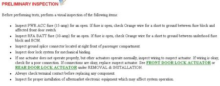

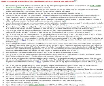

Does the manual have an installation guide or any wiring diagrams?
I sent it to your email so you can read it.

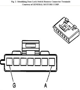

http://www.2carpros.com/forum/automotive_pictures/30961_capl_1.jpg
http://www.2carpros.com/forum/automotive_pictures/30961_capl1_1.jpg
http://www.2carpros.com/forum/automotive_pictures/30961_caplfig2_1.jpg
Thursday, April 24th, 2008 AT 8:56 AM
