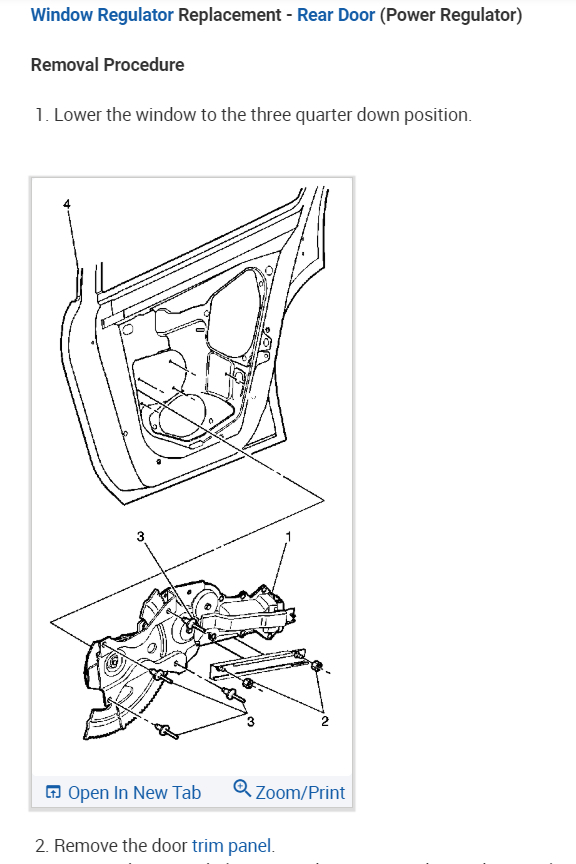

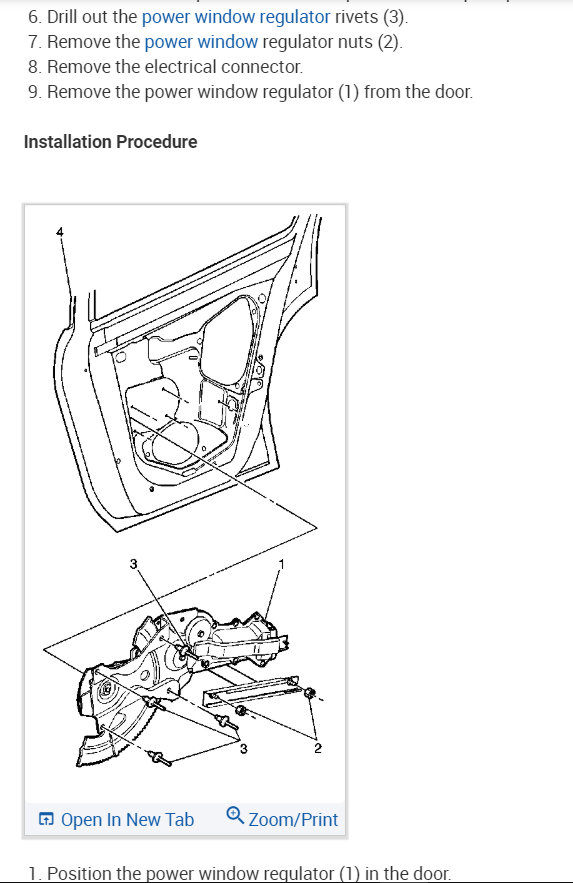

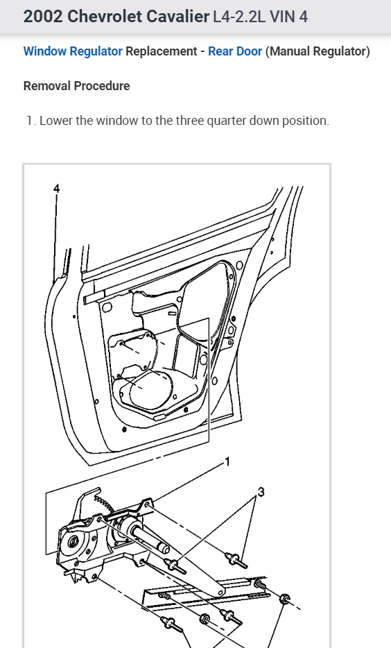

How do I replace the power window motor on rear driver side?
Aug 2, 2010 at 9:11 PM
HMAC300
  • CAR REPAIR CONTRIBUTOR
  • 48,601 POSTS
Here is a guide that will walk you through the etps with instructions in the diagrams below to help you on your car.
https://www.2carpros.com/articles/how-to-check-and-replace-a-electric-power-window-motor

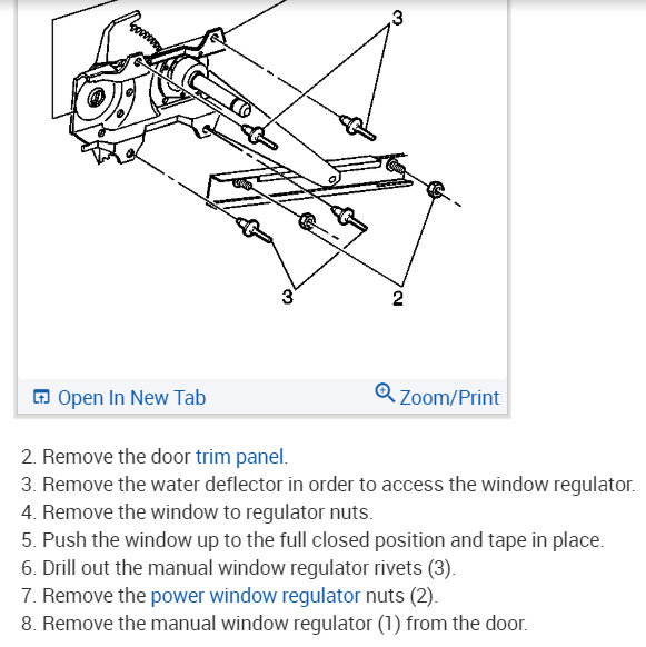

The front driver-side power window motor is in need of replacement. I can see that it is riveted on and I can drill those out. My problem is where the regulator (scissor-type) and motor attach: I have read that there is a spring mechanism that needs to be dealt with using a special tool. How do I detach the regulator from the motor safely and then attach a new motor correctly?

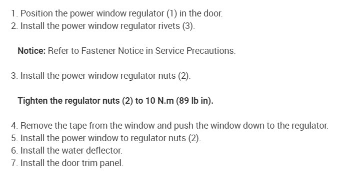

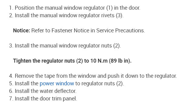

Pull inside door handle to full open position. Push in on door handle pull cup, while prying out at top with flat-blade tool. Pull up on door handle pull cup to remove.
On front doors of hardtop models, remove power door lock switch and power window switch. On front doors of convertible models, remove power door lock switch. See WINDOW
DOOR LOCK SWITCHES .
On all models, remove upper trim finish panel. Remove door trim panel lower screws. Remove door armrest. Remove door panel and set aside.
Remove water deflector enough to access motor/actuator assembly. Disconnect motor/actuator assembly electrical connector. Remove motor/actuator assembly bolts. Remove motor/actuator assembly.
To install, reverse removal procedure. Tighten motor/actuator bolts to 53 INCH lbs. (6 N.m).

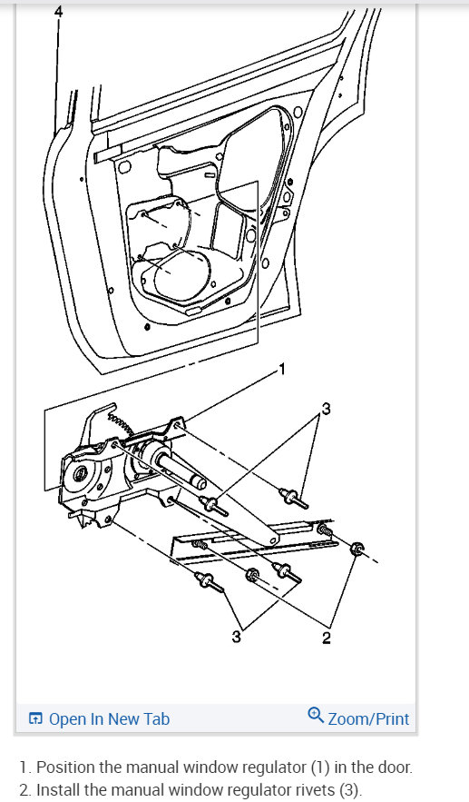

I got an answer that said to remove the door shell. On the Cavalier, once the door panel has been removed, there is nothing but sheet metal and a few holes through which some of the inner workings can be seen. I don't see any way to remove this sheet metal. Is the door shell the outer piece? On this site, the illustrations on R&R the power window motor show cleqr access to the motor, not so on the Cavalier. HELP! Should I just throw in the towel and take it all to a shop?
Apr 16, 2020 at 11:46 AM (Merged)
  • 54,328 POSTS
dont give up, some access to the window motors can vary, if the inner panel can not be removed you must remove the outter shell, it is easier than it looks. Please let me know how it goes.

How do I get into the inner door to remove and replace th epower window motor on my "96 Cavilier? I got the door panel off and switch disconnected but can't figure out how to remove the motor.
D5NUKE
  • 61 POSTS
To change the power window motor .. Remove the door shell of course
You will see the motor for the window .. Unplug the power.
The motor is actually riveted in so you need to drill out the rivets. You can drill these out through the door itself use a larger bit so you can see the rivets holding the motor to the regulator.There is 3 rivets.
CAUTION: Sure you support the window before you drill out the rivets as the window will fall when the motor is removed.use tape or a wedge to hold it up.
Dont use to large of a bit to drill the rivets holding the motor to the regulator as you will need to use the holes in the regulator for the new motor.
Remove the old unit .
Then install the new motor with self tapping screws . Plug in the power.
Good luck ..
