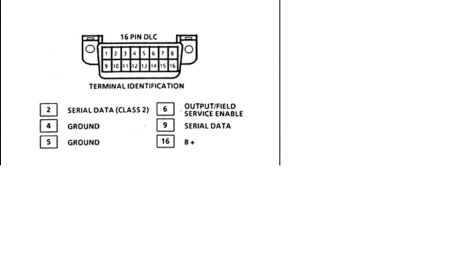

What was the fuel pressure spec? Does the pressure hold with engine off? Is there an injector pulse? Any applicable trouble codes? At the least, you need an obd2 code reader to check codes. Another thought is your security system, passlock, injector disable.
Friday, July 9th, 2010 AT 12:21 PM
LSHIVELY1
  • 5 POSTS
The computer system in the darn car has never worked so we can't get it to give us any codes whats so ever.
Friday, July 9th, 2010 AT 1:01 PM
INTERNETMECHANIC
  • 700 POSTS
Did you check voltage and grounds at the datalink connector? Pin 16 is voltage, hot all the time, you can use a testlite to check. Pin 16 gets voltage from the cigar fuse. Pins 4 and 5 are grounds. Below is a generic picture of gm obd2 datalink connector.
http://www.2carpros.com/forum/automotive_pictures/512072_gm_obd2_datalink_connector_1.jpg

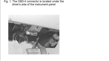

Where can I find the datalink connector at? The darn Chiltons book isn't helping me right now. Thanks for your hard work so far.
Friday, July 9th, 2010 AT 2:30 PM
INTERNETMECHANIC
  • 700 POSTS
My info says the datalink connector is under the dash, driver side.
http://www.2carpros.com/forum/automotive_pictures/512072_chevy_cavalier_datalink_connector_location_1.jpg
Friday, July 9th, 2010 AT 2:40 PM
LSHIVELY1
  • 5 POSTS
Okay thanks. Went and checked #16 and there was no live juice. So iI opened the fuse panel on the drivers side dash, by the fuse was there. I pulled it and replaced it and still have nothing.
